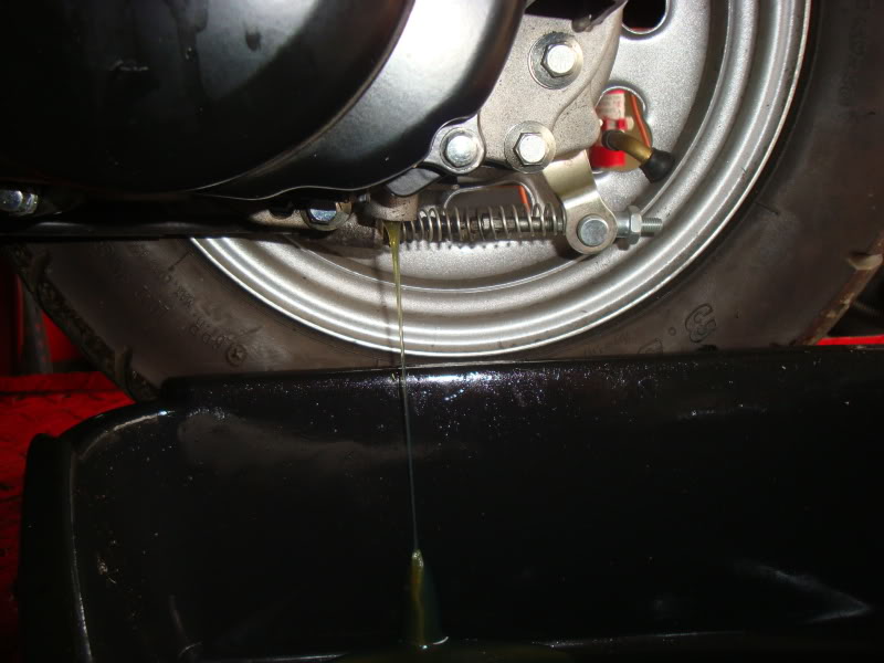

Vidanger l'huile de la boite de transmission
![[Image: 2_transmission.jpg]](http://www.scooter-chinois-4t.com/tuto/transmission/2_transmission.jpg)

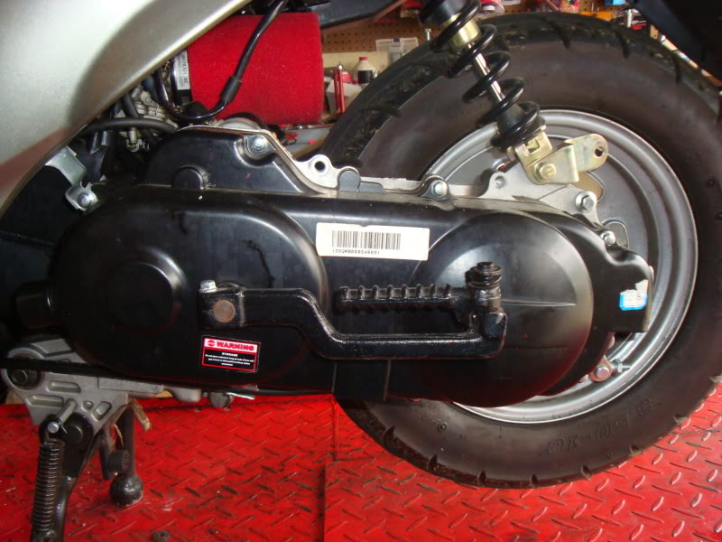

Retirer le carter de kick
![[Image: 1_transmission.jpg]](http://www.scooter-chinois-4t.com/tuto/transmission/1_transmission.jpg)
![[Image: 3_transmission.jpg]](http://www.scooter-chinois-4t.com/tuto/transmission/3_transmission.jpg)

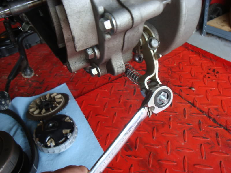

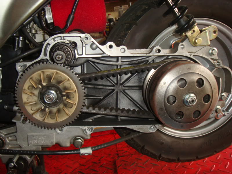

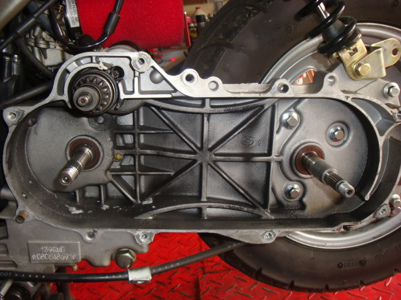

Retirer le variateur et l'embrayage
![[Image: 4_transmission.jpg]](http://www.scooter-chinois-4t.com/tuto/transmission/4_transmission.jpg)

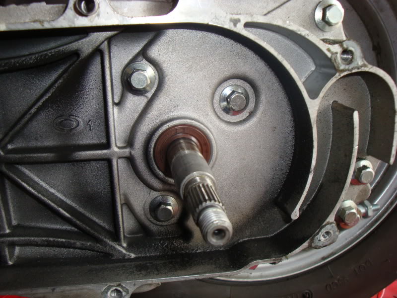

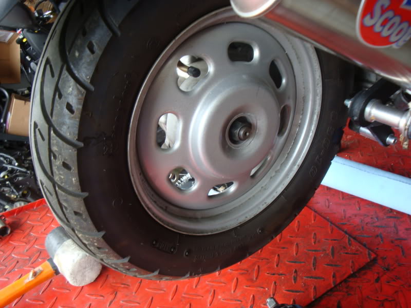

Retirer la roue arrière
![[Image: 30_transmission.jpg]](http://www.scooter-chinois-4t.com/tuto/transmission/30_transmission.jpg)
![[Image: 5_transmission.jpg]](http://www.scooter-chinois-4t.com/tuto/transmission/5_transmission.jpg)

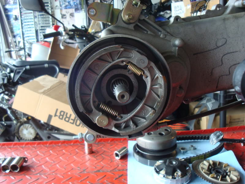

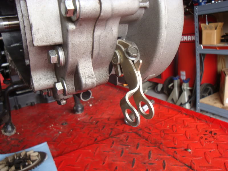

Enlevez le câble de frein arrière
![[Image: 6_transmission.jpg]](http://www.scooter-chinois-4t.com/tuto/transmission/6_transmission.jpg)
![[Image: 7_transmission.jpg]](http://www.scooter-chinois-4t.com/tuto/transmission/7_transmission.jpg)

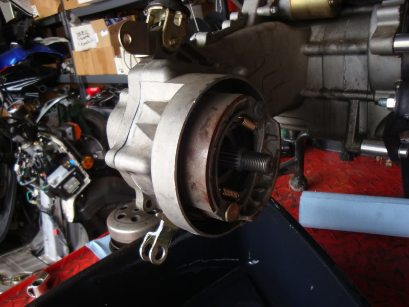

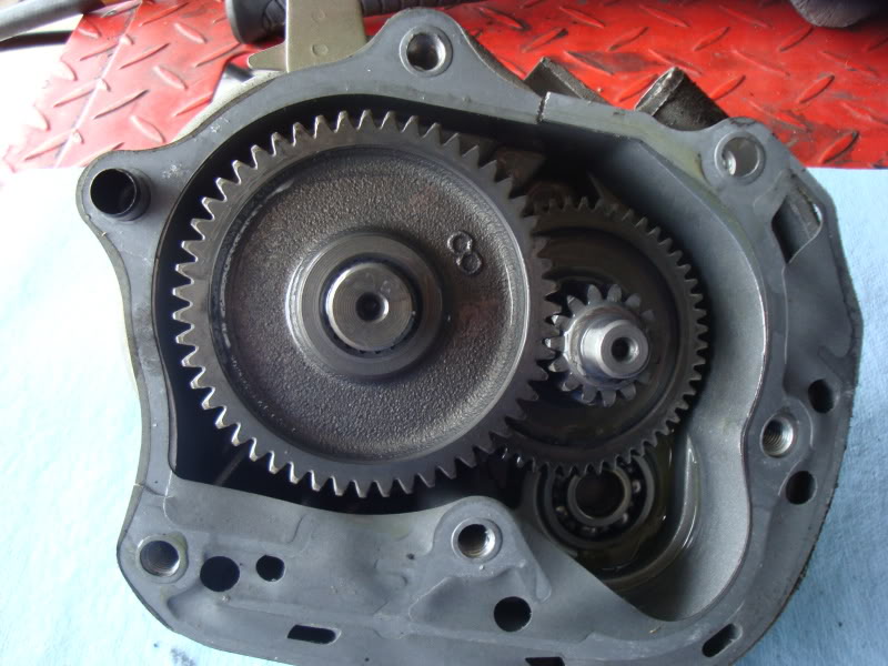

Retirez les 6 boulons de fixation de la boîte de transmission
(Noté qu'il ya un boulon plus long dans ce lot. Souvenez-vous de cela pour le remontage. )
![[Image: 8_transmission.jpg]](http://www.scooter-chinois-4t.com/tuto/transmission/8_transmission.jpg)
![[Image: 9_transmission.jpg]](http://www.scooter-chinois-4t.com/tuto/transmission/9_transmission.jpg)

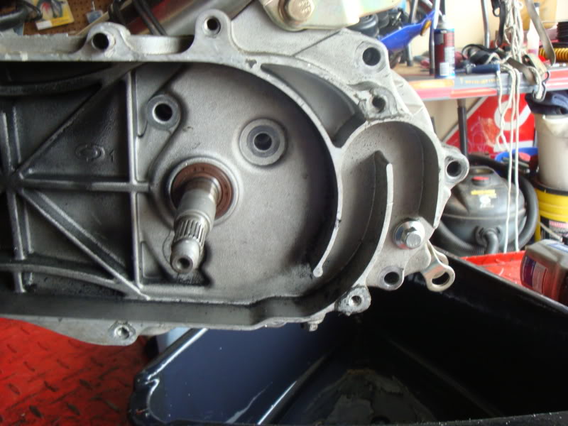

Assurez-vous que le bac de récupération d'huile est bien en place pour récupérer le reste de l'huile
![[Image: 10_transmission.jpg]](http://www.scooter-chinois-4t.com/tuto/transmission/10_transmission.jpg)

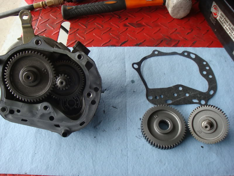

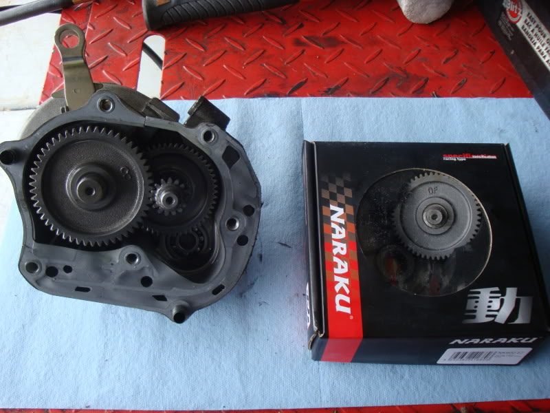

Voila votre transmission final
![[Image: 11_transmission.jpg]](http://www.scooter-chinois-4t.com/tuto/transmission/11_transmission.jpg)

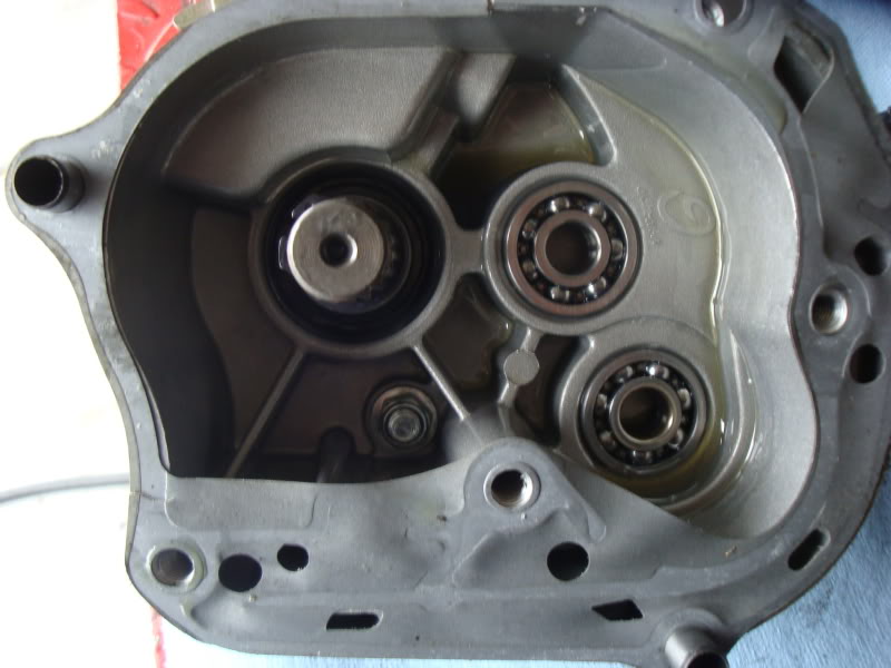

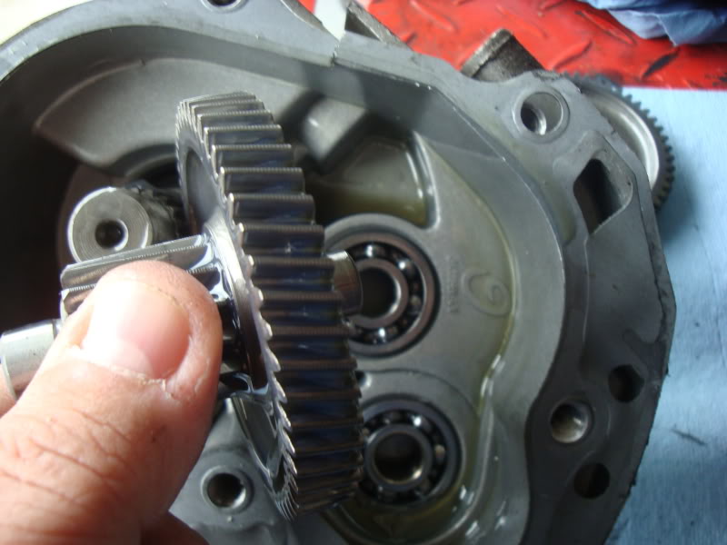

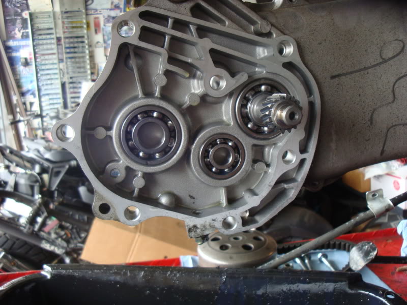

Les roulements
![[Image: 12_transmission.jpg]](http://www.scooter-chinois-4t.com/tuto/transmission/12_transmission.jpg)

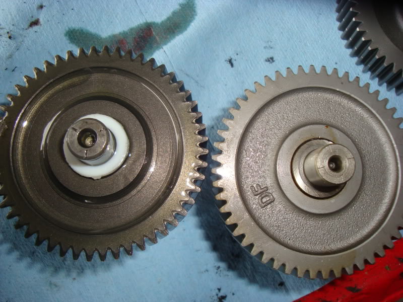

La transmission longue naraku
![[Image: 13_transmission.jpg]](http://www.scooter-chinois-4t.com/tuto/transmission/13_transmission.jpg)
![[Image: 14_transmission.jpg]](http://www.scooter-chinois-4t.com/tuto/transmission/14_transmission.jpg)

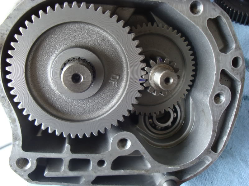

Enlever la transmission d'origine
![[Image: 15_transmission.jpg]](http://www.scooter-chinois-4t.com/tuto/transmission/15_transmission.jpg)
![[Image: 16_transmission.jpg]](http://www.scooter-chinois-4t.com/tuto/transmission/16_transmission.jpg)
![[Image: 17_transmission.jpg]](http://www.scooter-chinois-4t.com/tuto/transmission/17_transmission.jpg)

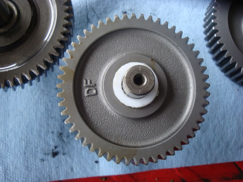

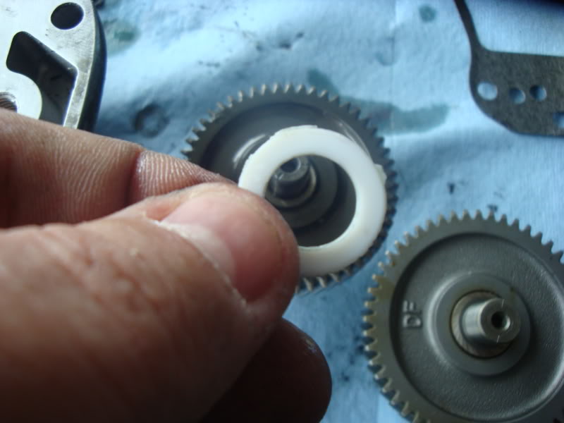

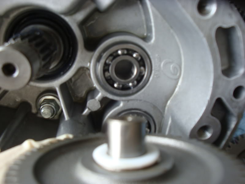

N'oublier pas de replacer l' entretoise en nylon sur le nouveau pignon
![[Image: 18_transmission.jpg]](http://www.scooter-chinois-4t.com/tuto/transmission/18_transmission.jpg)
![[Image: 19_transmission.jpg]](http://www.scooter-chinois-4t.com/tuto/transmission/19_transmission.jpg)
![[Image: 20_transmission.jpg]](http://www.scooter-chinois-4t.com/tuto/transmission/20_transmission.jpg)

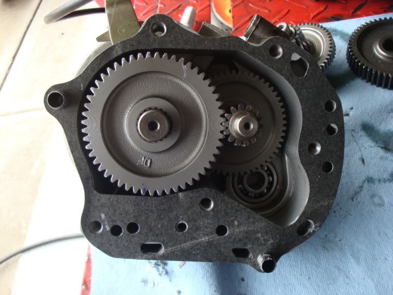

Nettoyer tous les résidus de vieux joint de la boîte de transmission
Installer la nouvelle transmission
![[Image: 22_transmission.jpg]](http://www.scooter-chinois-4t.com/tuto/transmission/22_transmission.jpg)
![[Image: 23_transmission.jpg]](http://www.scooter-chinois-4t.com/tuto/transmission/23_transmission.jpg)

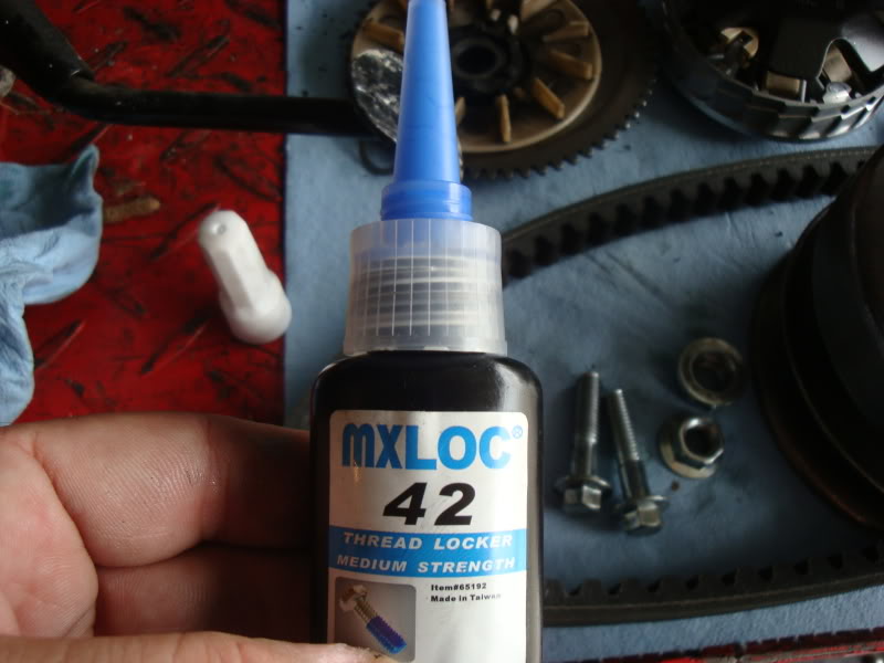

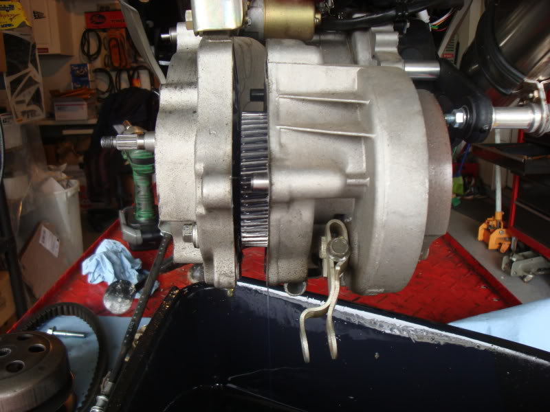

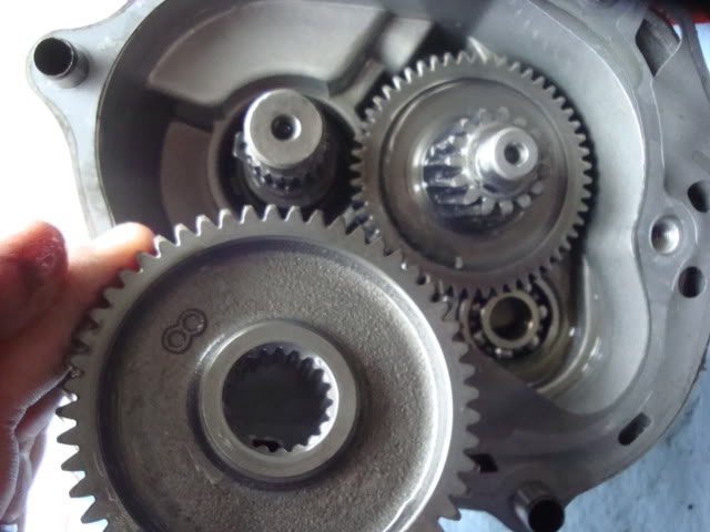

Utilisez un peu de loctite sur les boulons avant de les visser
![[Image: 27_transmission.jpg]](http://www.scooter-chinois-4t.com/tuto/transmission/27_transmission.jpg)
